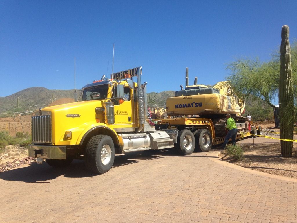

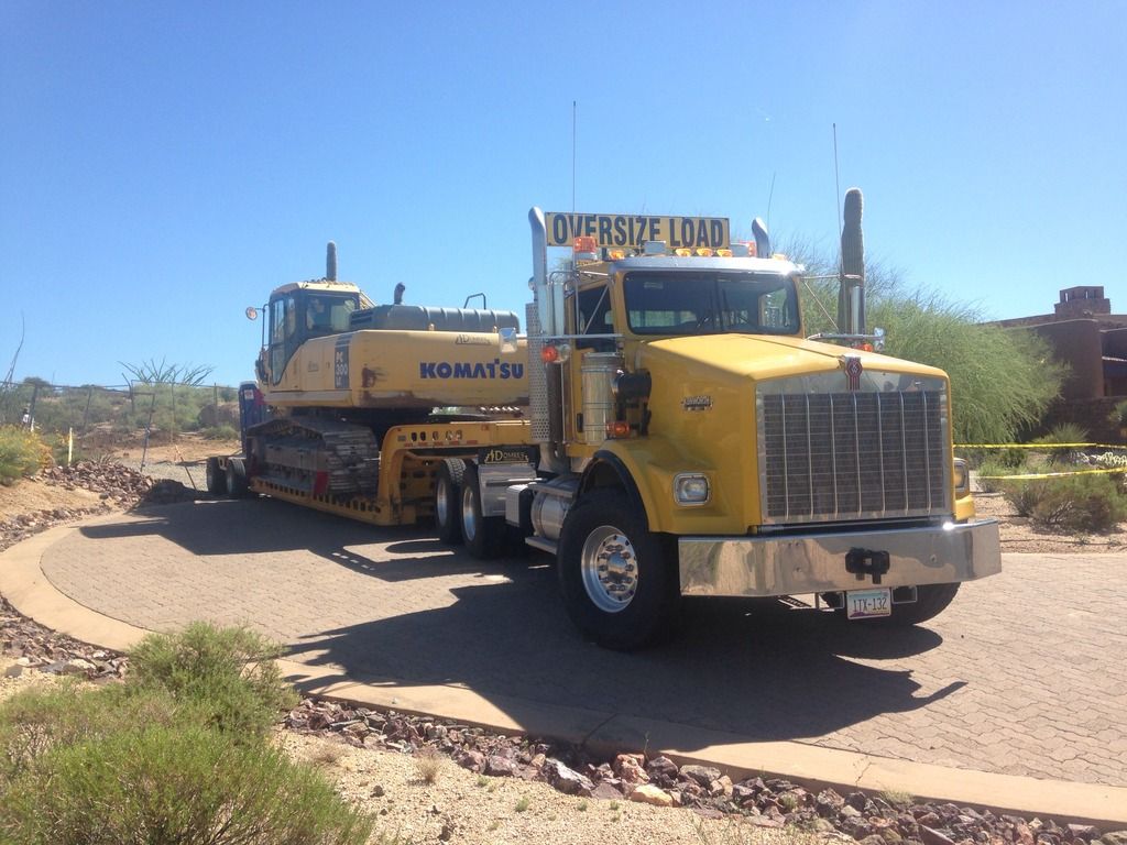

We have 3 Murray Trailers and we love them because they are so light. We can scale 92,000 on the one and the trailer weighs in the neighborhood of 13,500 pounds. The other thing is we load the excavators over the back all the time which makes it really fast and a lot easier. Most of our work is in really high end neighborhoods that are extremely tight and have neighbors that don't want any construction once their house is in. With our Murray we are able to back right up to the edge of the drive and get the machine off without touching the pavement and get out before they have a chance to get too upset =)
These are pics of a typical move for us that I had on my phone. Enjoy

Nice pics Dirtdude - as always, your yellow T800's look great in that AZ sunshine!
